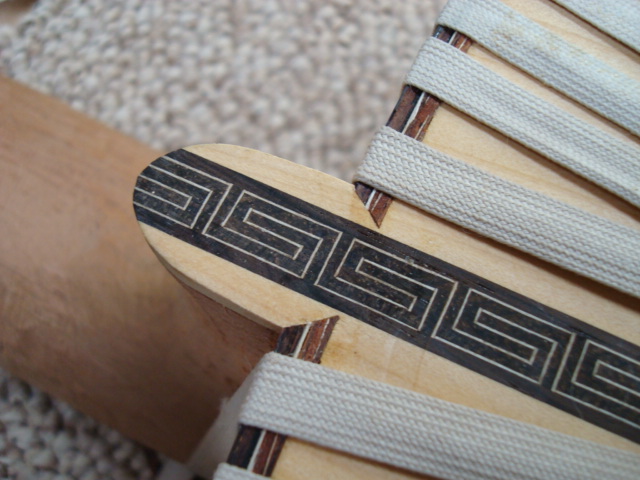

PostPosted: Thu Dec 06, 2007 8:43 am
Posts: 241
